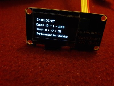

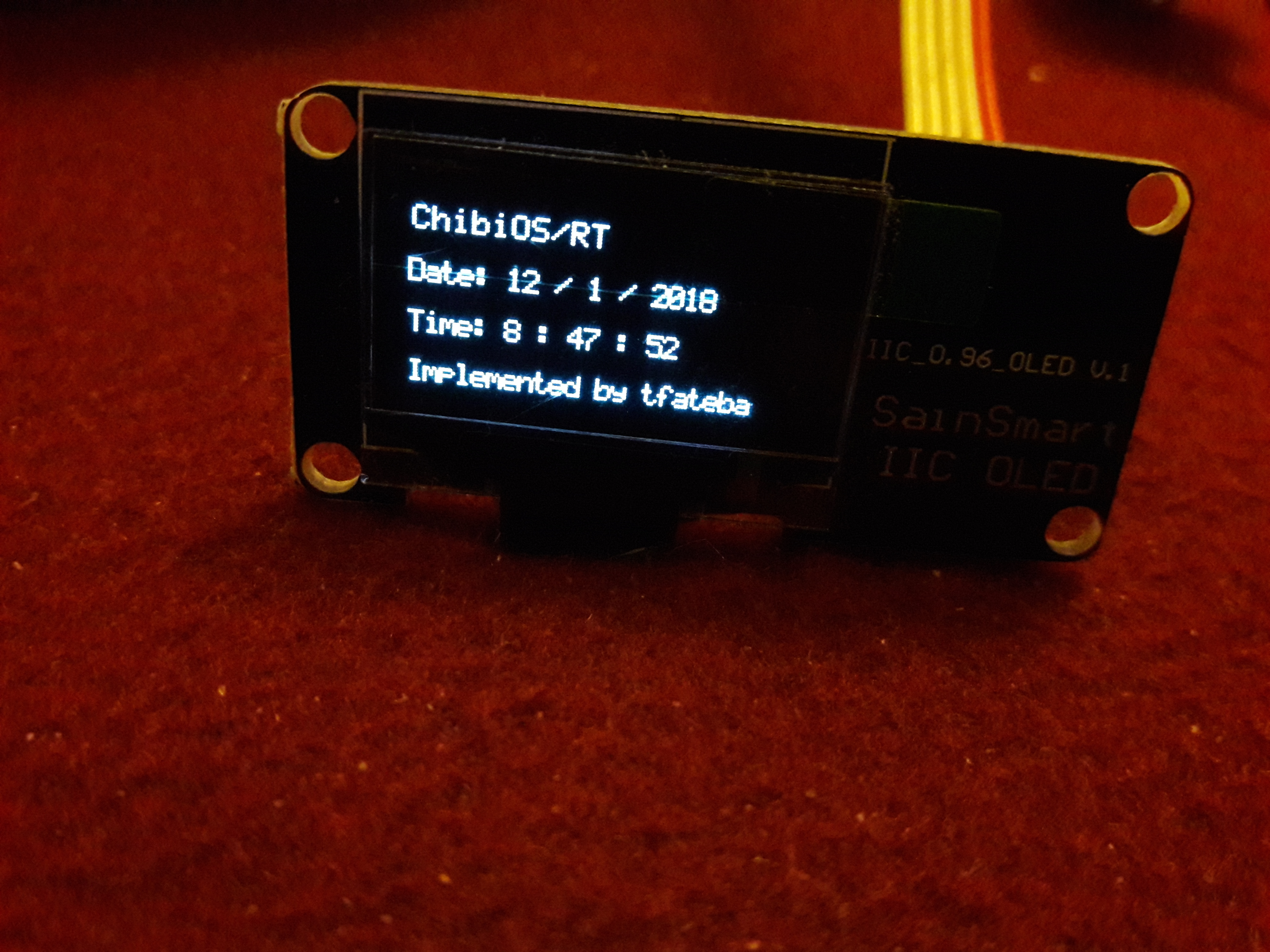

Post by tfAteba »
Ho here is also a photo to show the result :P
