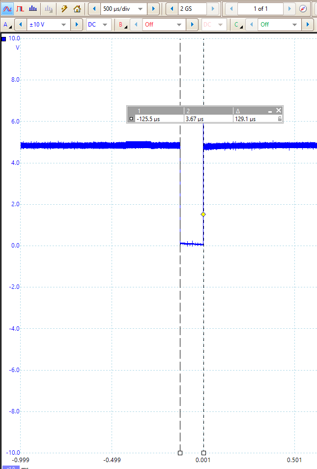

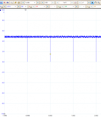

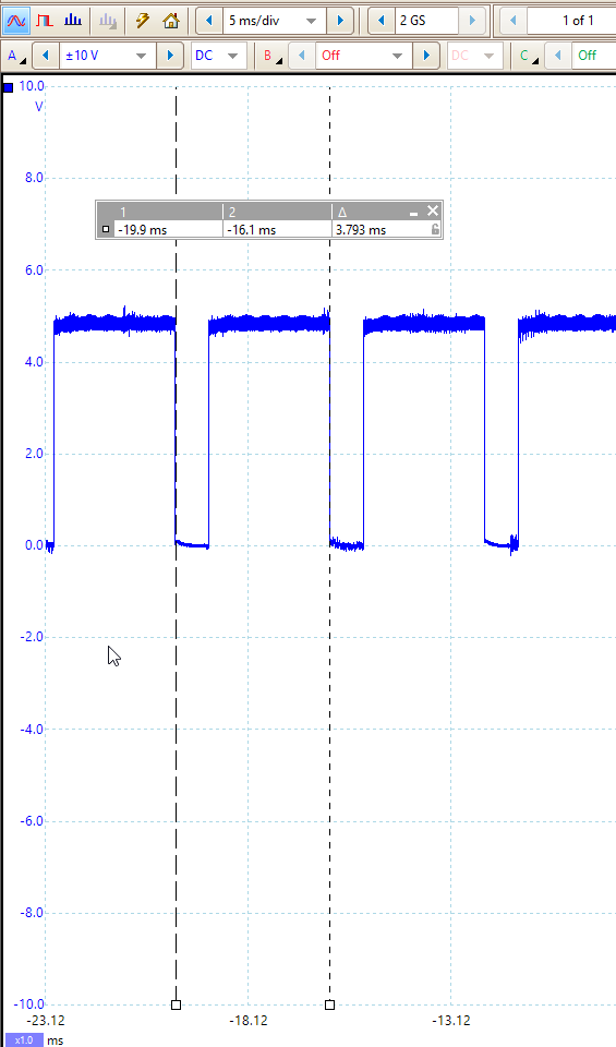

while trying out the ...ChibiOs\trunk\demos\AVR\RT-ARDUINO-MEGA\ example, I was not able to reproduce the behavior described in the readme file.
Out of the box, by only modifying the makefile according to my setup, I get this on pin13 of ArduinoMega (2560):
It seems that the system is periodically resetting;
by commenting out the following line:
" test_execute((BaseSequentialStream *)&SD1);"
it seems that the system is not resetting anymore, but the described behavior in the readme file is still not observable.
I would expect a rectangular signal 50% dutycicle with a frequency of 0.5Hz.
What I am getting instead is this:
with a 1s/div time base
with a 500us/div timebase
Can anyone confirm that this is happening, or am I doing something wrong???
Anyhow, what is the purpose of test_execute((BaseSequentialStream *)&SD1);???
Regards,
Victor

Hi Victor,
The system is not resetting, if you connect to the serial console, you will see the output of the ChibiOS bench mark also called ChibiOS Test suite.
By commenting this you are simply remove the execution of the bench mark. So your LED can immediately blink every second.
The purpose of this instruction is to make un bunch of test depending of the configuration you made. So some features can be tested: Here is for example the output of my board:
Code: Select all
