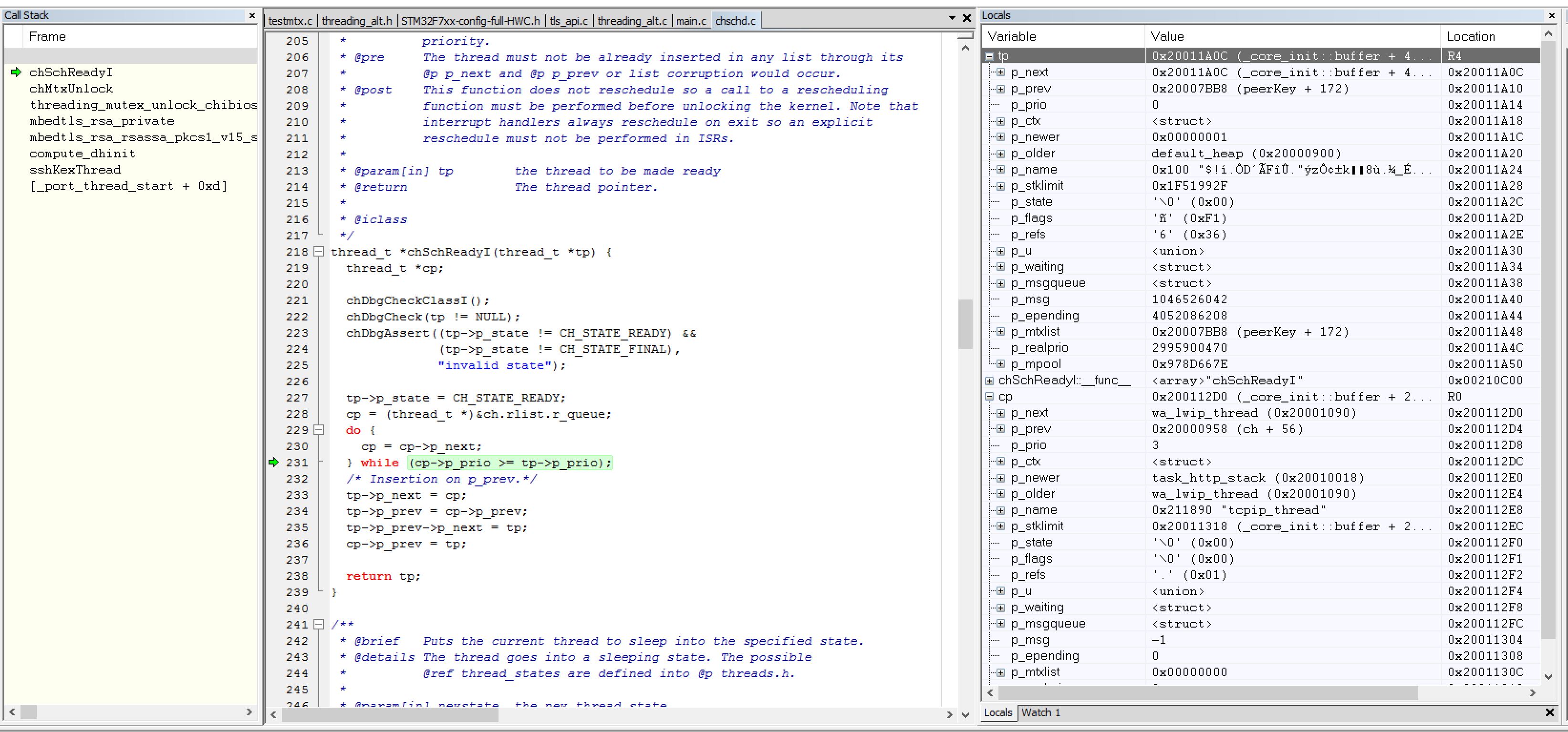

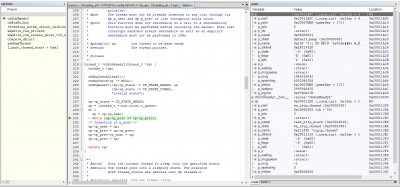

I'm trying to use chMtxLock/chMtxUnlock api for basic mutex usage, however the code gets stuck in the infinite while loop (see picture attached)
The scenario is very simple.
A processing thread gets spawned, calls an API function from mbedtls library, which requires taking a mutex, doing some processing and releasing the mutex.
Mutex is being initialized, i did check that, and there is no problem taking the mutex. There is only one thread for now, so there are no other threads that I'm aware of that are trying to take the mutex at the same time yet. However, when the processing function tries to release the mutex it took, i get this error.
The interesting part is that i testing the same code but using the cmsis_os api, where the binary semaphores are being used, and it works without any issues.
Can anyone shed some light on this? What should i look for? I stepped through the code and it doesn't look like stack or a mutex object is being corrupted.
