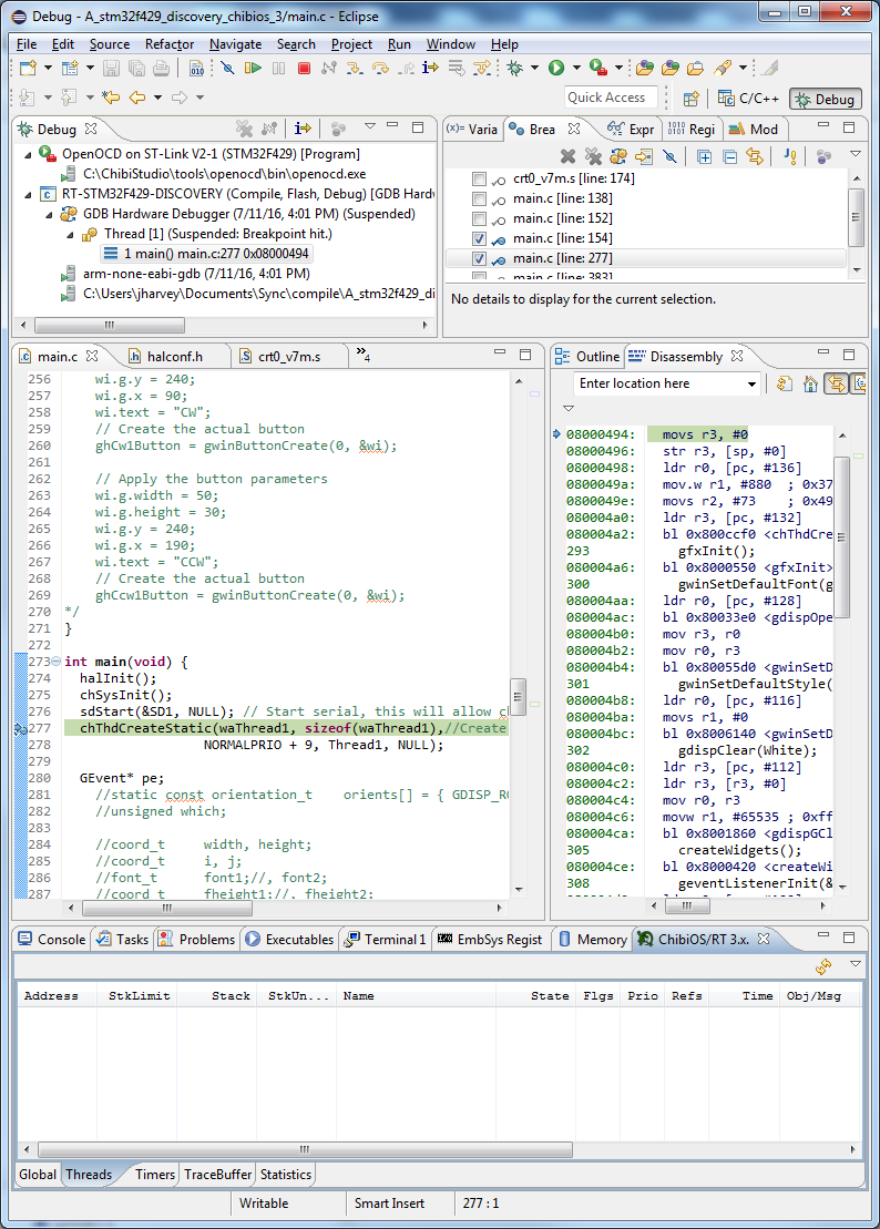

I'm having some troubles with ChibiOS Debug View, I have followed a brief tutorial found here http://www.playembedded.org/blog/en/201 ... ibistudio/ However the results are shown below.
You can see that the board is running, and has stopped in main.c, the ChibiOS Debug View shows no data.

You need to step past chSysInit() or the debugger does not detect the OS because it is not initialized.

This picture more clearly shows that we have just past chSysInit by a little bit, and still no data in ChibiStudio.

Have you clicked the "refresh" button? it is the yellow one on upper left of the window.
The refresh operation can be slowish, depending on the used debugger HW, so it is performed on demand only.

Ah, press the magic button. I see information now. Thanks for the tips and tricks.
