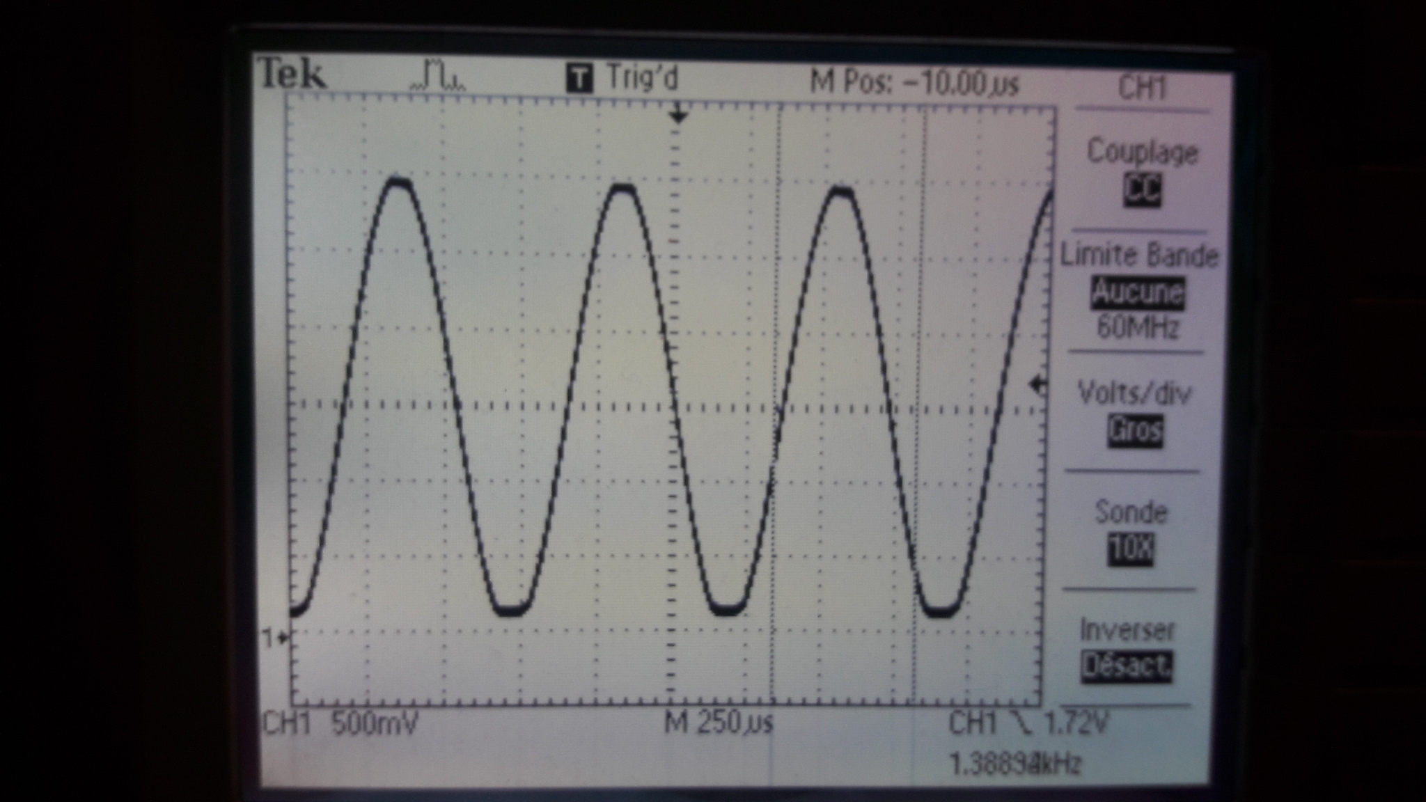

I used ChibiOS_16.1.5, and made a first test with the file testhal/STM32/STM32F4xx/DAC/
Here is what I change to make the demo works for STM32F429I_discovery:
- Makefile
    1) The board name: include $(CHIBIOS)/os/hal/boards/ST_STM32F429I_DISCOVERY/board.mk
    2) The linker script: LDSCRIPT= $(STARTUPLD)/STM32F429xI.ld
- main.c: I removed the following at line 74 because my board don't have an LED attached to this PIN.
  if ((nz % 1000) == 0) {
    palTogglePad(GPIOD, GPIOD_LED3);
I added a pin configuration for the LED on GPIOG Pin 13.
palSetPadMode(GPIOG, 13, PAL_MODE_OUTPUT_PUSHPULL);
I also added in the while loop:
palTogglePad(GPIOG, 13);
That it, and it works for the testhal application. I have attached a picture of the result.
I suggest you to start like this and if it work you can make you own application.
I'm now going to test your code to see if there is a mistake :)
