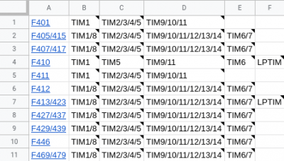

os/hal/ports/STM32/LLD/TIMv1/hal_gpt_lld.c is used by all STM32, as far as i can see. STM32F4
r13226 ([font=Courier New]svn diff -r13225:r13226[/font]) removed the default handler for 9/11/12/14.
https://drive.google.com/open?id=1YXVZh ... j_vZhW_RtM
