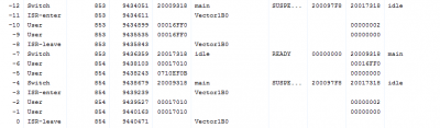

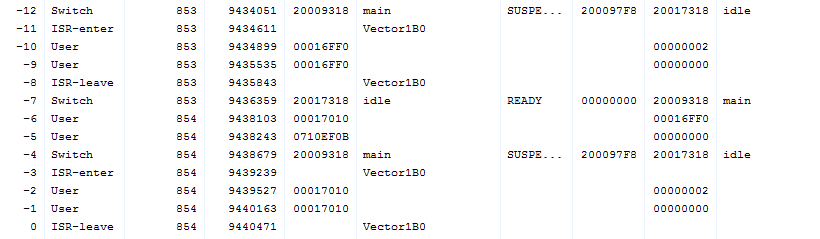

Probably the clearest example is shown in .
Steps -12, -4 are the start of a QSPI transaction; set it going, then wait in the idle thread
Steps -11, -3 are the QSPI interrupt which occurs on completion of the transaction
Steps -10, -2 show AR, SR early on in the ISR
Steps -9, -1 show AR, SR after executing the QSPI "end of transaction" macro
Step 0 is an abnormal completion - AR is OK in the ISR exit, but zero in the idle->main context switch
Looking at the code flow from step 0, it's as follows:
OSAL_IRQ_EPILOGUE(); // Checks AR; non-zero
_port_irq_epilogue();
_port_switch_from_isr()
chSchDoReschedule()
thread_t *otp = currp;
/* Picks the first thread from the ready queue and makes it current.*/
currp = queue_fifo_remove(&ch.rlist.queue);
currp->state = CH_STATE_CURRENT;
/* Handling idle-leave hook.*/
if (otp->prio == IDLEPRIO) {
CH_CFG_IDLE_LEAVE_HOOK(); <--- Corruption detected here
