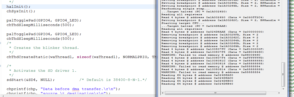

Thank You very mach. All files of DMA_MEMproject and of LPC43xx port was dowloaded from svn://svn.code.sf.net/p/chibios/svn/trunk_old by Tortoise svn . Project was builded successfully. I am debug project by JLink. Led switch on and switch off. But problems are present. First calling "chThdSleep" causes
Target Halted. Makefile equal original. Linker script was elited for LPC4357.

Re: Demo project for LPC43xx, problem
In makefile you need to change
to
# LPC43xx boot select: ram, spifi_flash_debug, flash.
ifeq ($(LPC_BOOT_SELECT),)
LPC_BOOT_SELECT = ram
endif
to
LPC_BOOT_SELECT = flash
endif
