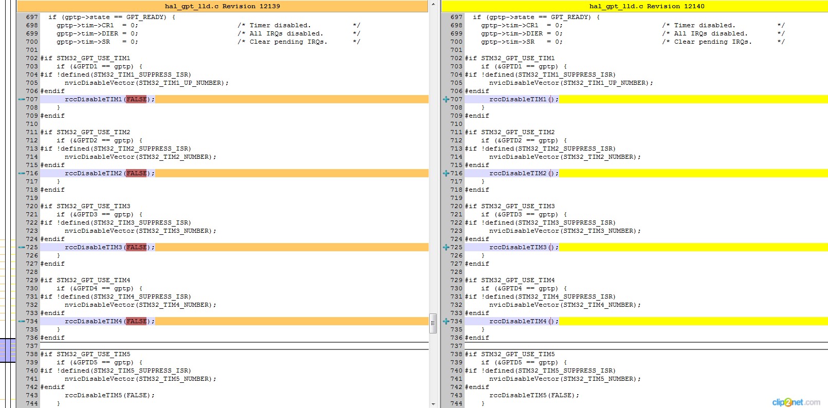

This error is for the TIM2, TIM3, TIM4 also, because "FALSE" was lost:
[img]
[/img]
Re: Compile Error GPT TIM1
Fix committed, thanks.
