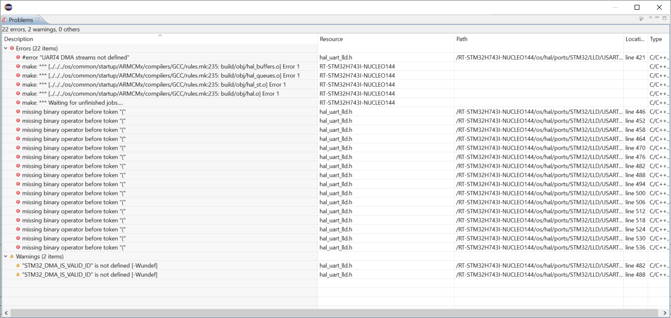

I have encountered some probles working with Chibios(latest version) and UARTs and STM32H7.I take the example project called RT-STM32H743I-NUCLEO144 and enabled usage of UART in mcuconf.h and in halconf.h, but the complition resulted in errors shown bellow:

Which version of ChibiOS? trunk seems to not be affected.
BTW, I fixed some other clock-related UART problems on H7 as bug #1021. I found those looking for your problem.
