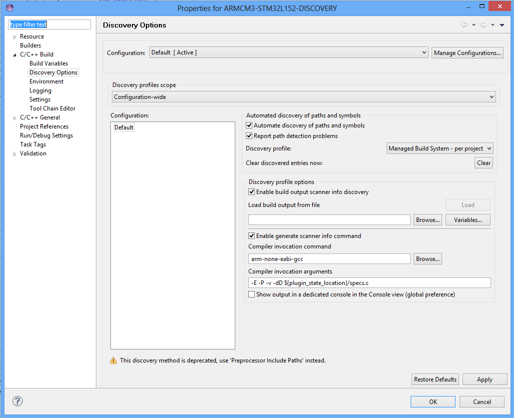

Giovanni, it seems you have same problems I do with ChibiStudio in regards to autocomplete and indexing in general, but it is maybe only me: if you open random project STM32L152 demo for example, then in main:
halInit: resolved
chSysInit: resolved
sdStart: unresolved
SD1: unresolved
palSetPadMode: unresolved
palReadPad: unresolved
TestThread: resolved
spiStart: unresolved
palSetPad: unresolved
adcStart: unresolved
adcSTM32EnableTSVREFE: unresolved
pwmStart: unresolved
PWMD4: unresolved
chThdCreateStatic: resolved
chThdSleepMilliseconds: resolved
I see you have disabled all of the code analysis too, so it looks I'm not the only one. Bug in the new CDT? In Indigo with CDT 8.02 I have every code analysis on and the indexing is rock solid and everything is resolving. So am I having some local issue or it is same with you too and I need to look deeper?
DrunkenDonkey
Posts: 124
Joined: Sun Aug 28, 2011 5:16 pm
Re: ChibiStudio preview 4
Post by DrunkenDonkey »
Workeeeeeeeeeeeeeeeeeeeeeeed :D
Anyway, making the discovery options per project like on the pic I have my indexer working again
