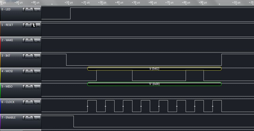

I have another question. We are communicating via spi with a wireless module. The module generates an interrupt when data is received or when data is ready to be transmitted. I have initialized the EXT driver, and it reacts on an interrupt. In this interrupt callback function, an interrupt handler for the wireless module is called. In this handler, an interrupt register is readed over spi, and the intterupt status is saved in a temporary variable. But after sending the register address to the module, the spiSend function doesn't return, and the receive function isn't called. It looks like the whole os is frozen.

The led is not turned off in the mrf_read_short function, so the function spiSend wont return. Am i doing something wrong here?

EDIT:
I attached an image of the logic analyzer I used.
Logic analyzer
Logic analyzer
Re: STM32VL Discovery serial problem
The code is not complete so I am assuming you are calling spiSend() and spiReceive() from the callback.
A callback is called from the context of an ISR, this means you can call only I-class functions from there. spiSend() is:
1) A synchronous function that suspends the invoking thread, you cannot suspend an ISR.
2) Not I-class.
The correct approach is to call spiStartSendI() instead which is:
1) Asynchronous, the function starts the transfer and returns immediately.
2) I-class.
Note that spiStartSendI() signals the end of the transfer with another callback where you can call spiUnselect() and finish the operation.
This kind of errors is caught by the state checker, you can enable it in chconf.h. It is recommended to use the debug options during development.
Note that things like I-class are described in the "kernel concepts" chapter in the documentation.
Alternatively you can wakeup a thread from the EXT callback and perform the SPI operation from the thread using synchronous functions.
