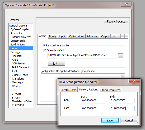

Well I finally could get rid of all errors but the code doesn't seem to be downloaded to the board :/
Is there anything else that I must enable in the halconf.h file?

Well I managed to get rid of all errors finally :D
But when I download the code it just doesn't run on the board.. I was using the demo main.c provided for the STM32F3 Discovery board.
That's awkward..
Re: STM32F3 Discovery - IAR
The project contains several settings that should be modified in the linker section, note that F3 and F4 have different RAM sizes, you need to change some addresses/sizes there.
You should also be able to debug, does the program at least enter the main function?

No it doesn't enter the main function,In fact I can't even debug step by step ..

Thank you Giovani I really appreciate your help and especially your patience :D
I got it working finally.
I realised tha I missed out on those settings.
Good, please look all the tabs in the linker section and compare with the F4 project.
