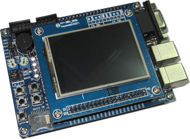

Hi!
This is small simple demo and board files for HY-STM32 development board.
HY-STM32.7z
Project
(9.61 KiB) Downloaded 732 times

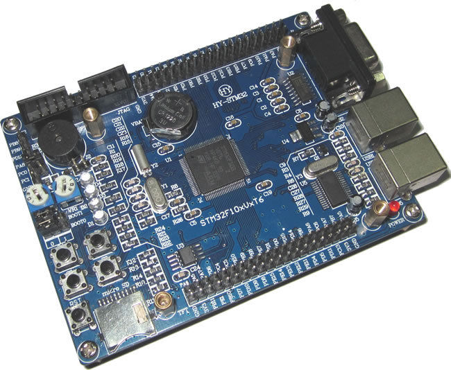

Description:
  • CPU: STM32F103VET6(ARM Cortex-M3), LQFP100; FLASH: 512K Bytes, SRAM: 64K Bytes
  • 1 x JTAG debug interface
  • 4 X Status LED, ONE Power LED
  • 1 X RS232, supports 3-wire ISP.
  • 1 X USB2.0 SLAVE device interface.
  • 1 X USB to serial Converter, based on PL2303-HX.
  • 1 X Micro SD (TF) card socket, interface with SDIO connection mode.
  • 1 X 2.4-inch TFT (240X320 ILI9325 (with touch panel IC ADS7843) interface, can be controlled via MCU, FSMC 16-bit interface mode.
  • 1 X SPI bus control M25P16 (16MB) serial Flash to store your data, like picture, character and so on!
  • 4 X User buttons
  • 1 x RTC with battery back-up battery holder(Battery is included).
  • Important GPIO port Lead out, convenient for your Application!
  • Board Size: 105MM X 79MM
µGFX demo in future...
Re: Board HY-STM32F103VE
Good work, moved in the Contributions forum.
Good work indeed! Now let's see if we can work out the distorted image problem with the LCD :)
