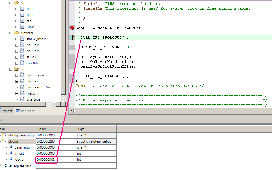

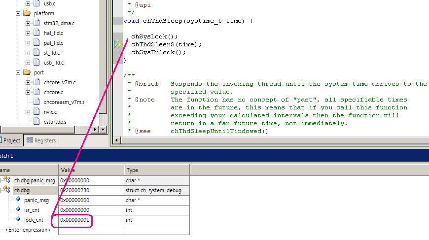

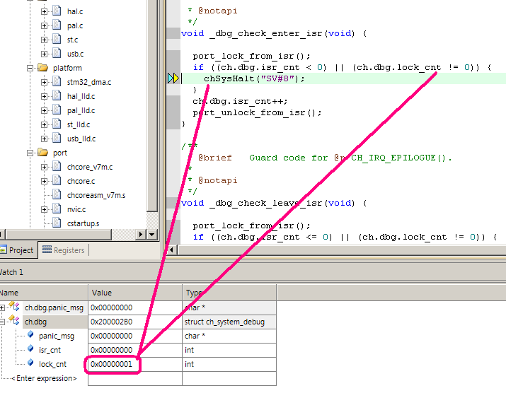

Problem was found in ChibiOS/RT 3 (rev.7788): with enabled debug in chconf.h
#define CH_DBG_SYSTEM_STATE_CHECK           TRUE
#define CH_DBG_ENABLE_CHECKS                TRUE
#define CH_DBG_ENABLE_ASSERTS               TRUE
Interrupt from timer TIM2 (STM32F105) generated after chThdSleepS() calling and before chSysUnlock(), resulting in lock_cnt != 0
Please suggest what is the reason and how to fix that. Is this a some sort of bug related to IRQ disable/enable while context switching or something?

step 3
step 3
step 2
step 2
step 1
step 1
