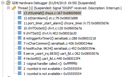

FYI the previous version (with assertion in line 480 commented out) ran with no problems for 51 hours.
Applied the very latest updates about 2 hours ago. Have done two test runs, and in both cases it halted with 'stStopAlarm' within 10-20 minutes.
It may be relevant that the ChibiOs plugin is showing zero active timers, which is wrong - as a minimum, my main loop is a simple while (1)chThdSleepMilliseconds(500);
This happened off a USART received character interrupt; probably the first of a new message. Thus it would be starting a 'stopped' timer (which is then retriggered on successive received characters).
Any other information I can extract for you?

This is very wrong, it looks like something happened when the last timers has been removed, it stops when the list is empty by calling stStopAlarm() twice for some reason...
My test case did not trigger this.
Re: Getting stuck with tickless mode
Hi Steved,
Are you sure it is "stStopAlarm"? I am asking because that function does not have an assertion. Please post the full stack trace if you can.

Giovanni wrote:Hi Steved,
Sorry, was falling asleep when I wrote that - it was stStartAlarm.
Here's stack trace as well.
Stack trace leading to stStartAlarm

Thanks, I am working on creating better tests for this beast.
Is the UART interrupt at higher priority than systick? this would explain the problem: UART preempts systick after the list has been emptied but the alarm is still active, then the UART callback calls chVTSetI() and the alarm is started again triggering the assertion.
Easily fixed, tomorrow I will commit this fix and other general improvements to tickless mode.

Giovanni wrote:Thanks, I am working on creating better tests for this beast.
I wondered that. Thought it was OK, but maybe I'm reading the numbers wrong.
Pretty much everything is as the 32F051 Discovery demo unless I had good reason to change it.
#define STM32_ST_IRQ_PRIORITY 2
#define STM32_ST_USE_TIMER 2
#define STM32_UART_USART1_IRQ_PRIORITY 3
#define STM32_UART_USART2_IRQ_PRIORITY 3
