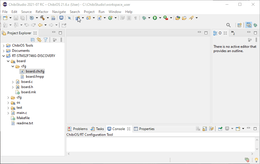

Fresh studio install in C:\
Latest Java 64 installed
When I select .chcfg and hit generate button or menu, nothing happens.
No console output, only button and configuration menu disappers:
Tried it on two Win10 64 machines (both fully updated) with the same result.
ChibiStudio 2021-07 Win10 64 & Board.chcfg not working Topic is solved
