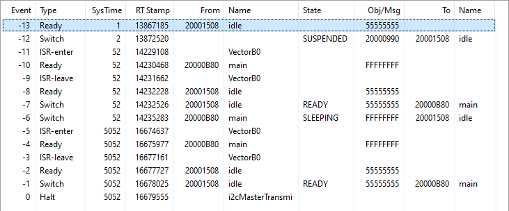

However I'm not sure how to read this.
What I found is, that at entering [font=Courier New]i2cMasterTransmitTimeout[/font] the second time [font=Courier New]i2cp[/font] state is already at [font=Courier New]I2C_LOCKED[/font].
[font=Courier New]osalDbgAssert[/font] then enters [font=Courier New]chSysHalt[/font]
Attached are the statistics from start till entering halt.
Re: I2C never sends a bit
That is an assertion in the i2cMasterTransmitTimeout(), probably the driver is in an invalid state when you call the function, inspect the assertion condition in there.
