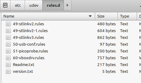

Another question, I'm afraid. When running openOCD, do you run it as root? Or have you set up some udev rules?
Re: Linux debug configuration
There are udev rules in the openocd folder, just place them like this:
You also need to add the group "dialout" to your user if I remember well.

Sorry, but no sign of a directory with udev rules in it.
And some of the tools for launching OpenOCD mention version 12 (binary name openocd_12); that doesn't appear to be present either.
Sorry, my mistake, most of those are in the STM32 Cube Programmer under:
/STMicroelectronics/STM32Cube/STM32CubeProgrammer/Drivers/rules
A big rules file is in OpenOCD under, it should include everything:
/ChibiStudio/tools/openocd/contrib/libdcc60-openocd.rules
Probably you only really need this one.

Thanks that worked. Probably my remaining niggles are due to the age and type of the Nucleo board I'm using (not sure that serial over USB should work with the L031).
