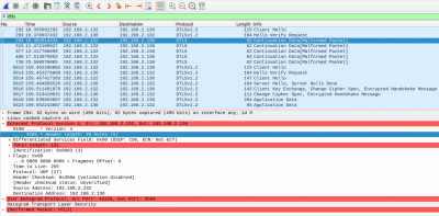

One issue is still present what I'm struggling with. That one is around the lines with for(q = p; ...) macWriteTransmitDescriptor() in low_level_output(). I have said before that I'm using mbedtls and DTLS... mbedtls allocates buffer and uses it to encrypt data into one UDP packet in there and then pass the buffer to LWIP. LWIP has not enough place in buffer, can't prepend data in the buffer with UDP header, therefore splits the buffer into two and pass it to low_level_output() as linked list struct pbuf *p. So far there is nothing suspicious about. The problem is now that putting parts of the UDP packet one by one on the ethernet in the for-loop results in malformed packets, see dtls-corrupted.png.
The only one solution, I have found, is to rebuild the packet with pbuf_clone() and send it out in one piece. See mac_hal2.zip. Replacing the loop with pbuf_clone() results in awaited behaivour as can be seen from the packet No. 5812.
What's your opinion?

I did not realise that by macWriteTransmitDescriptor() the driver should have only written to device's internal buffer and put that buffer on the ethernet only after macReleaseTransmitDescriptorX() has been called. That's it.
