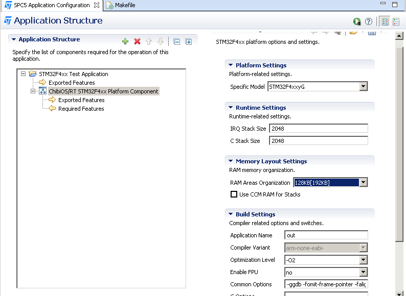

Err, I think it will be moved to next week... a problem with a proprietary compiler supplier... it is sad because the tool has been ready since December :(
I can give more info anyway, ChibiOS will be included for SPC5xx devices but you will be able to update it from ChibiOS update site and get components for other platforms too (working on STM32F4 already, then F3 and F0).
There will be meta-components too, for example, if you include in your application the component "ChibiOS/RT for STM32f4xx" it will incorporate also the dependent components Kernel, HAL, STM32F4xx Board, etc. The RTOS will be ready and integrated in your application with 3 clicks: Add Component, click on component, OK.
Other things like the C++ wrapper, the shell, chprintf, the test suite will be embedded in components as well and can be simply added to the application. No need to mess with makefiles anymore (but the result is always a Makefile application that you can compile without Eclipse).
Users will be able to add their own components too, the process is very simple and the SDK is included. All you have to do is to create an "Update Site" where other users will be able to get the component and update it when needed. This potentially will make partecipating to the SPC5/ChibiOS ecosystem much easier because you can just start offering components and just announce the URL.
You can already see part of the components on http://www.chibios.org/eclipse and get an idea, you cannot install them yet because a dependency not present in standard Eclipse.
Another screenshot:
