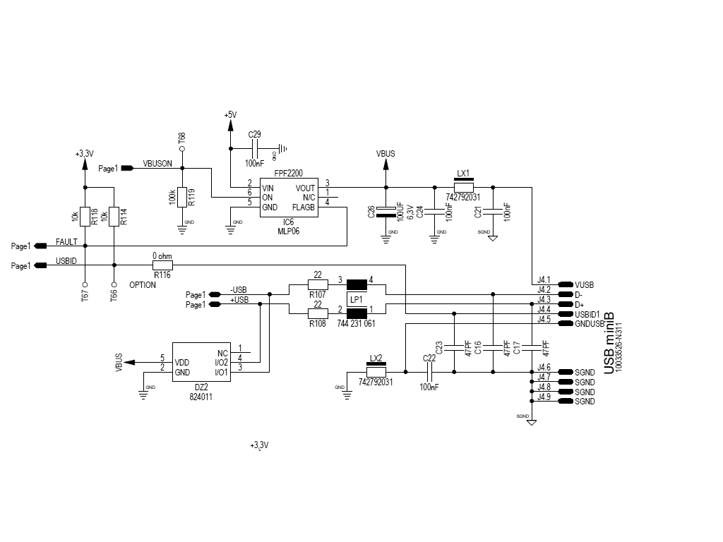

-custom board (see usb scheme attached)
-usb over serial code pasted from UDB_CDC demo ( f107 devices ,connectivity line)
-chibios system seems to work correctly
-same usb pinout config as testhal demo : usb pins as input ( usb redirects pin automatically)
-systems continue running well, just does not care about usb ..
USB CONNECTOR SCHEME
USB connector scheme
When i plug the cable o i reset the chip i got USB_EVENT_RESET but i never get USB_EVENT_ADDRESS or USB_EVENT_CONFIGURED..

So , can someone prepare a short list of what i've to check in order to narrow this problem ?

As you said it was an HW issue..OTG_VBUS does not get connected to USB VBUS on the connector.
SORRY FOR HOURS YOU WASTED. My hardware specialist will pay for that :D ( iwas kidding ..)
