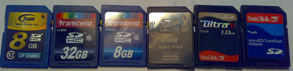

Hi.
Today specifically bought 4 new cards for testing:
1. Transcend SDHC 8Gb 6 class.
2. Team SDHC 8Gb 10 class.
3. GOOD RAM 8Gb 10 class.
4. Transcend SDHC 32Gb 6 class.
All card work with driver without modifications. It seems the init problem is only in old SD cards.
Some benchmark (read 48 kb to internal memory 100 times starting from 0 sector, write same 48 kb buffer from internal memory 100 times, All debug options on, compilation optimization off):
Transcend SDHC 8Gb 6 class:  read 10810 kb/sec, write 7855 kb/sec
Team SDHC 8Gb 10 class:      read 10690 kb/sec, write 7339 kb/sec
GOOD RAM 8Gb 10 class:       read  7418 kb/sec, write 2845 kb/sec
Transcend SDHC 32Gb 6 class: read 10434 kb/sec, write 6357 kb/sec
Sandisk SD 1Gb Ultra II:     read 10300 kb/sec, write 7754 kb/sec
Sandisk uSD 1Gb:             read 10191 kb/sec, write 3086 kb/sec
It seems 'GOOD RAM' very BAD RAM :) (on label MADE IN JAPAN).
Test my SDXC 64Gb card I was afraid - I check it later.
