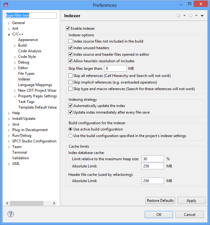

Workspace indexer settings like that looks to work okay too, it allows you to turn on the C++ analysis options too on default. Right-clicking and forcing the analysis to run results in mind-bogging amount of errors, something that works with indigo, but if you don't do that it works just fine in normal project files. I had to add a line in Project's C/C++ General/Paths and Symbols->Includes tab: I copied the already present line
c:/chibistudio/tools/gnu tools arm embedded/4.7 2013q1/arm-none-eabi/include
and added it on top, otherwise it seems it can't find few standard defines line uint16_t. Looks like the fact this line is "last" has something to do, but still unsure how can I alter default variables to move it on the top without having to manually add it. Again, that works just fine with indigo (might aswell switch back but hey, juno is newer)
