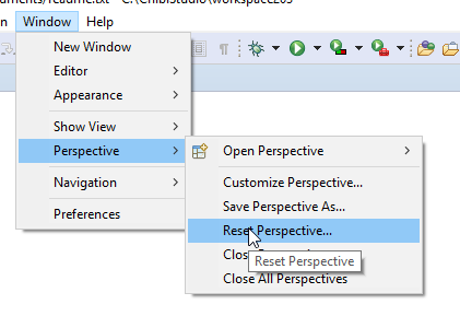

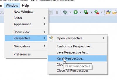

We stored the current workspace layout in the workspace option. If you mess your workspace and you want to go back to the initial setup you can just reset the perspective and you don't need to re add the custom windows

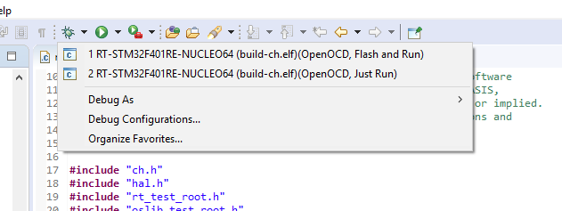

3. Generation of the launch configuration
The debug launch configuration are not attached to the project anymore. This could be disorienting because your launch menu will appear empty
Empty launch menu.png (8.45 KiB) Viewed 32846 times

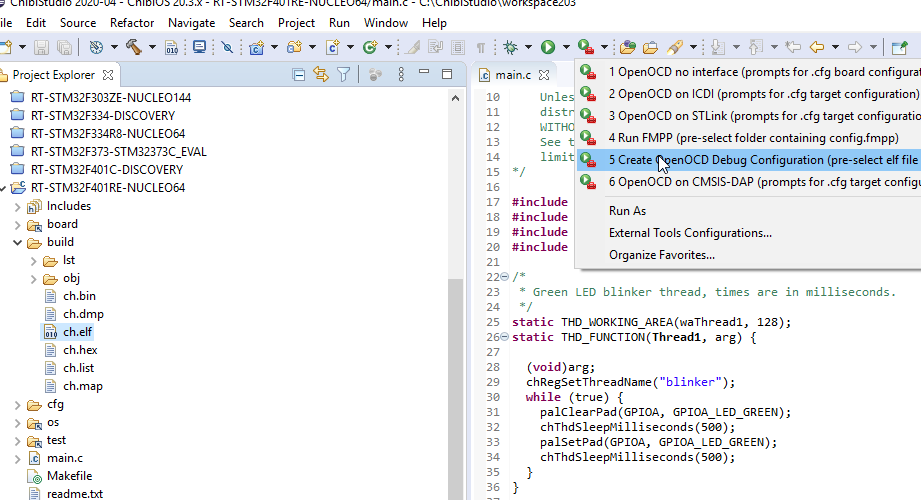

Anyway, the generation is straightforward:
  1. Build your target
  2. Select your elf file in the build folder
  3. Choose "Create OpenOCD Debug Configuration (pre-select elf file into a project)" from the external tool menu
When the generation is completed you'll see a message in the console
Generation done message.png (7.05 KiB) Viewed 32846 times

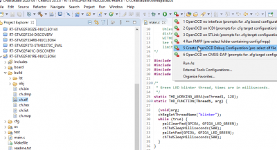

Select your project and refresh it (Press F5) and you will see the new launch configuration available into the menu
