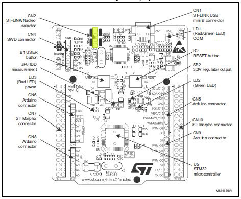

SWD uses PA13 and PA14. Your code doesn't edit that PIN (unless you have changed board files). You can try to use Automatic Mode (ST Link Utility->drop down menu named "Target") to perform a chip full erase: start full erase than connect USB cable.
Check if the Jumper on the ST-Link are both connected (see the following figure)
If you aren't able to connect to the target through the ST Link Utility maybe your hardware is permanently damaged.
