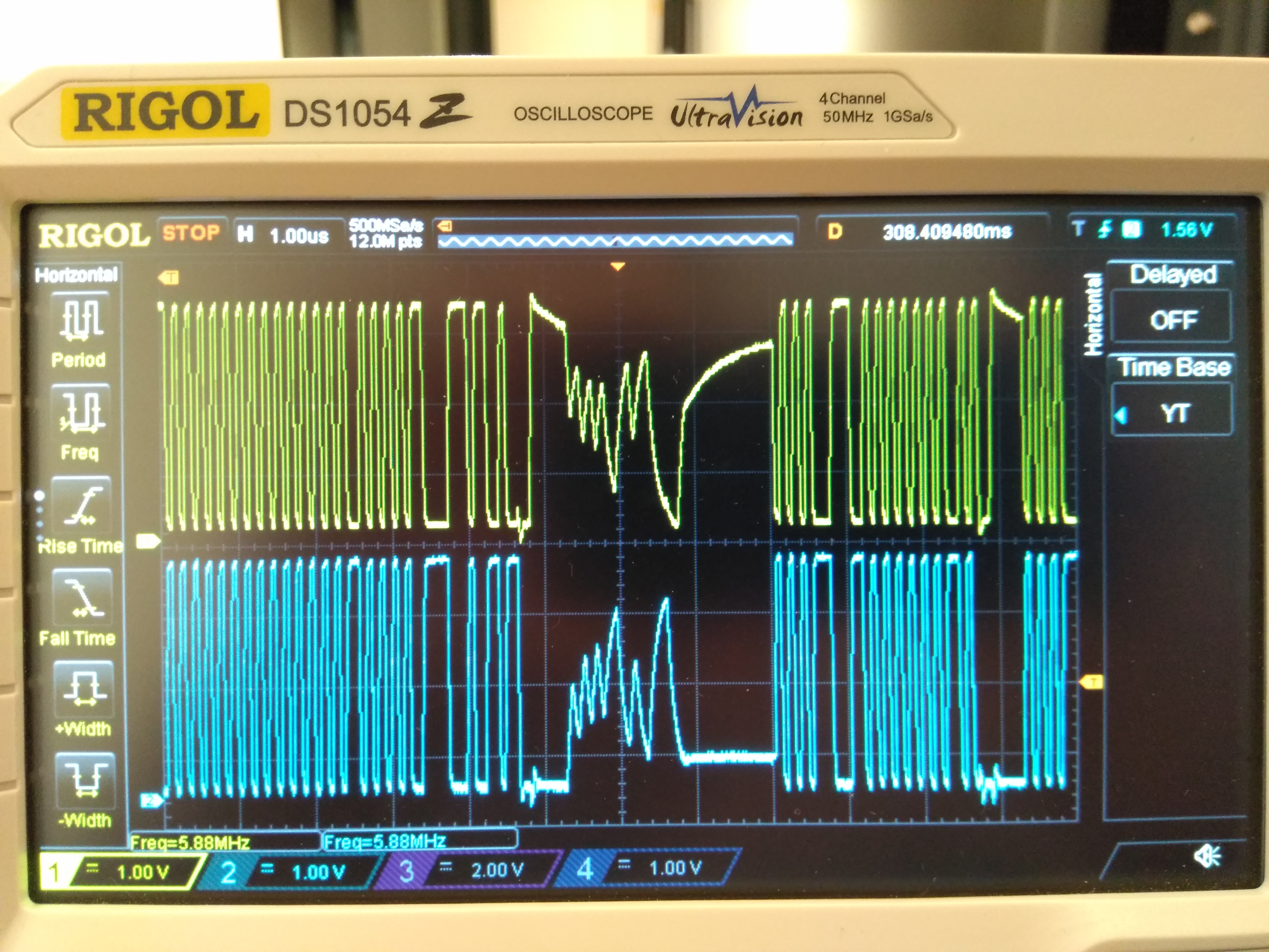

Attached you will find a screenshot from sigroc logic analyzer as well as from my scope.
It looks like after the data0 of the setup there is garbage on the line.
I can't tell if this is caused by the peripheral not doing the right thing or a hardware problem.
Here its "SYNC ERR" to the right:
Here its in the middle of the screenshot:
Other than that garbage, the signals looks good to me.
Cheers
Vinz

Can I suggest you set up the scope to look at those signals in differential mode? That way you'll have a better idea of the actual logic levels seen by the CPU. It may be that the data is always one or zero; or maybe there are edges which cause the data to be misinterpreted.

steved wrote:Can I suggest you set up the scope to look at those signals in differential mode? That way you'll have a better idea of the actual logic levels seen by the CPU. It may be that the data is always one or zero; or maybe there are edges which cause the data to be misinterpreted.
Hi Steved,
thanks for the hint. At this point i don't think it is worth the effort though.
I tend to agree with Giovanni that this is probably another issue between the driver and the usb peripheral.
Once this has been verified / disproved i will do more measurements.
Cheers
Vinz
