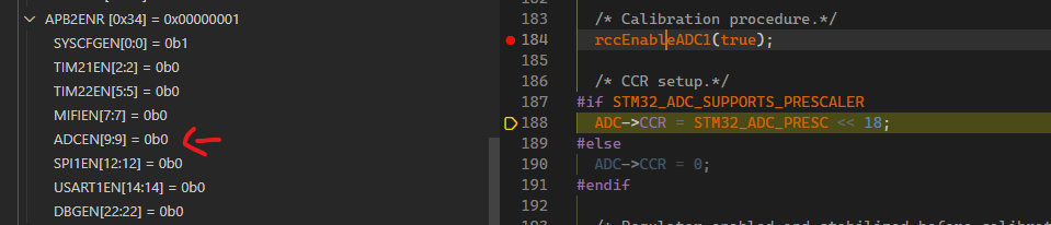

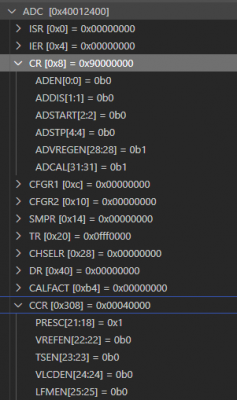

Peripheral while stuck:
Tried both STM32_ADC_CKMODE_PCLK_DIV4 and STM32_ADC_CKMODE_ADCCLK

I'm having trouble comprehending the behaviour. ADC clock is enabled but the ENR stays at zero...

I don't know, is it still zero while it is running in the loop?
You may try to change it from the debugger too.

I feel like a fool, it ADCEN is now set and calibration succeeds... No idea what fixed it. Now trying to backtrack.
