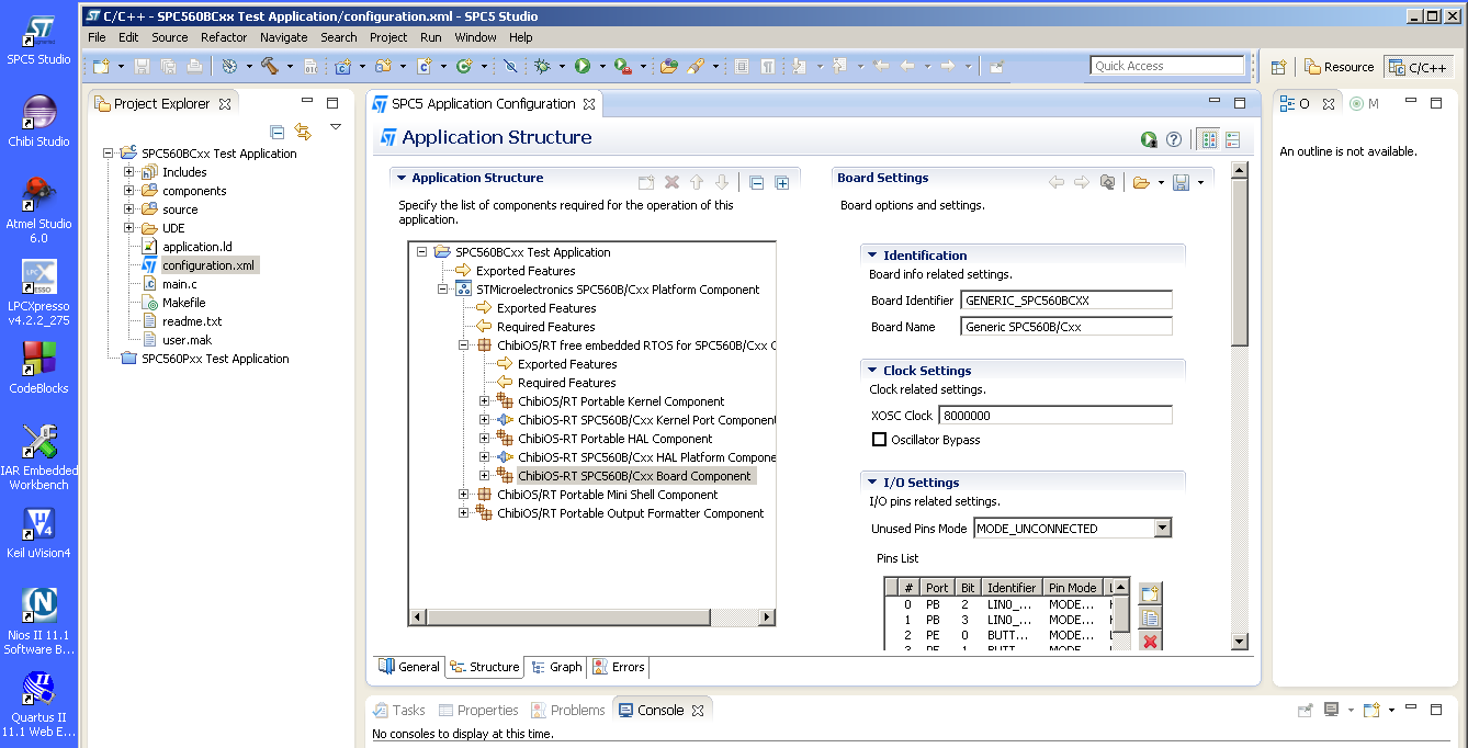

There is no really reason to not give more details about the environment, look at the following screenshots:
On the left there is the "application tree" a tree of all the components that are included in the application, you may notice how ChibiOS/RT has been split in visually handled components, it is like it was designed with this in mind, what a coincidence
On the right there is the really interesting part, it is the equivalent of the board configurator, note that each component is visually configurable.
The SPC5 studio includes also an SDK for components, an existing library can be encapsulated in a component and given a visual configuration, for example it would be possible to encapsulate lwIP or FatFS and have their configuration files generated automatically by the visual configurator. The configurator uses FreeMarker as template processor, just like the ChibiOS old configurator (just a coincidence of course).

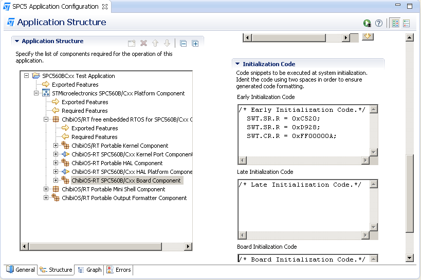

Another detail of the configurator:
Note that it is possible to write code in there that is placed in the generated board.c.
