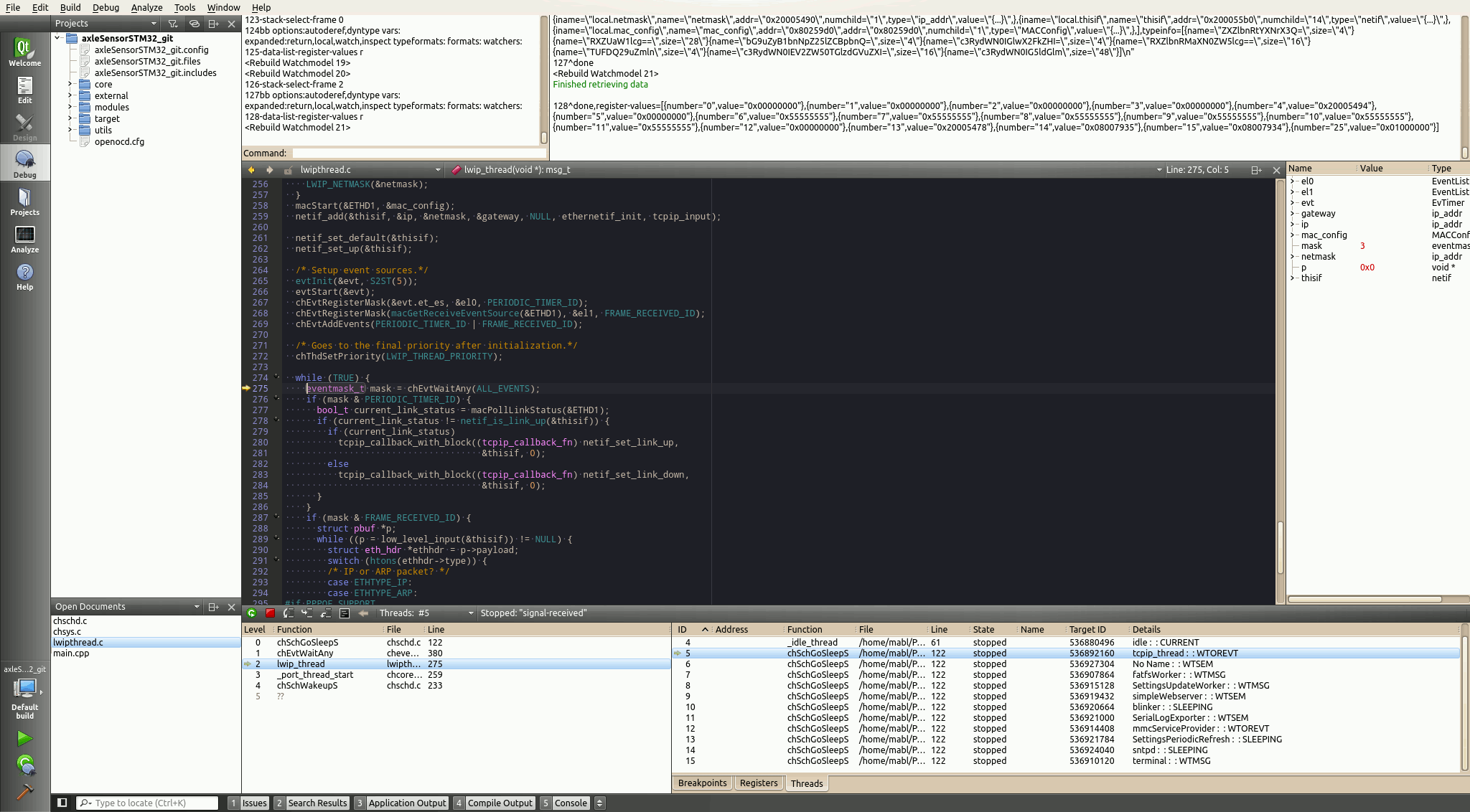

qtcreator has received lots of improvements recently, to support embedded programming and openocd with threads. :mrgreen: Most recent one:
https://codereview.qt-project.org/#change,38108
And pics or it did not happen:
Re: ChibiOS OpenOCD support
mabl wrote:You should see the same error with your non-rtos openocd.
Good point.
Post by gmb42 »
@mabl
I saw in your screenshot you have an openocd.cfg file, presumably this makes the command line for openocd simpler.
Currently I use a command line of:
openocd -f board/stm32f4discovery.cfg -c "stm32f4x.cpu configure -rtos ChibiOS;"
but I can't work out how to push those arguments into an openocd.cfg file. Do you have any idea?

Post by mabl »
Hi gmb42,
typically I create a openocd.cfg file for my targets like this
telnet_port 4444
gdb_port 3333
source [find interface/olimex-arm-usb-ocd-h.cfg]
# GDB can also flash my flash!
gdb_memory_map enable
gdb_flash_program enable
source [find target/stm32f4x.cfg]
Probably you can replace the two source by one single source to board/stm32f4discovery.cfg. This config has the advantage that you also easily enable flashing from gdb via the "load" command.
You can then call openocd via
openocd -f openocd.cfg -c "stm32f4x.cpu configure -rtos auto;"
I hope this helps?
