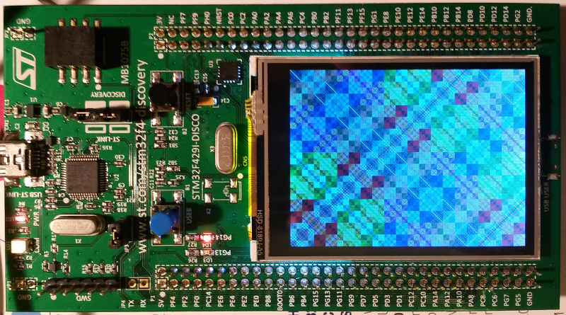

Finally, I've got it! ;)
I still haven't tested all of the features nor documented all of the code yet, but this is already more than enough for now :D
@ Tectu: I'll send you a pull request from my forked SDRAM demo (SDRAM not used anyway), with the current LTDC driver and a few fixes.
Fullscreen XOR texture with Wolf3D palette
