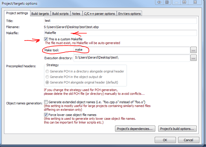

Tectu wrote:I had a lot of contact to the Em::Blocks author and he's more of aware of my and Giovannis wish to have the Makefile support. But it won't happen soon.
No, I'm not!
If I knew then I would told you that it already can use external makefiles and that a lot of people are using it this way.
Makefile options
Makefile options
and if you have chosen the make file option, you will get new build options like this:
Make options
Make options
If you use external makefiles with EmBlocks 2.30 please update the compiler DLL because of some bug fixes.
http://www.emblocks.org/forum/viewtopic ... t=10#p3150
So, no it won't happen soon because it is already there (right from the start).
