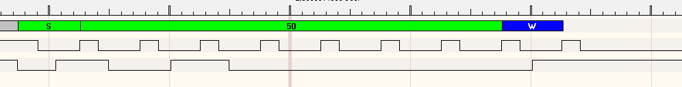

Currently I'm developing an application that uses hot-pluggable I2C nodes. To determine if a node is connected, I use a loop to poll all the addresses where nodes could possible live.
When read-through-write to a address that's not available my application breaks and waits forever in the _unhandled_exception(). When I logic analyse the data, it looks like this:
(click for large)

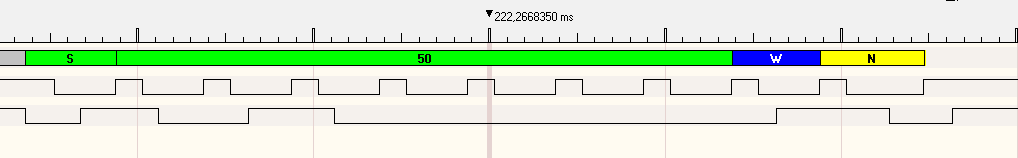

But when I run the application and try to read from a nonexisting address, it keeps looping in the
void i2c_lld_master_transmit(I2CDriver *i2cp, uint16_t slave_addr,
uint8_t *txbuf, size_t txbytes, uint8_t *rxbuf, size_t rxbytes) {
while (!(i2cp->id_i2c->SR1 & I2C_SR1_ADDR))
On the logic analyser, it looks like this
Is there a way to let the application time out after a number of milliseconds?
