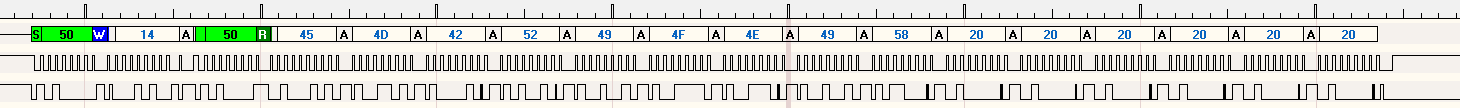

I'm currently encountering problems when reading more than 3 bytes (16 in my case) from an I2C node.
I'm having the I2C_SUPPORTS_CALLBACKS set to false, therefore my code uses the i2c_lld_master_receive on line 985 of i2c_lld.c
After reading 15 bytes, it gets stuck at the
while (i2cp->id_i2c->CR1 & I2C_CR1_STOP)
;loop.
And it never never never exits that loop. When I logic analyse the data, it looks like this:
