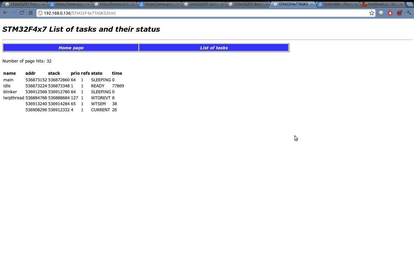

I have successfully ported ST netconn demo from AN3966 "LwIP TCP/IP stack demonstration for STM32F407/STM32F417 microcontrollers". There is one issue - I don't know how to get running threads list (common to vTaskList in FreeRTOS) to show in dynamic page.
Re: STM32 Ethernet Demo
You have to use the "registry", this is an example:

DeusExMachina
Posts: 223
Joined: Tue Apr 03, 2012 5:08 am
Has thanked: 3 times
Been thanked: 3 times
Post by DeusExMachina »
Thanks, I'll try.
DeusExMachina
Posts: 223
Success :) Now there is more complicated web server using F4 discovery & PHY DP83848
