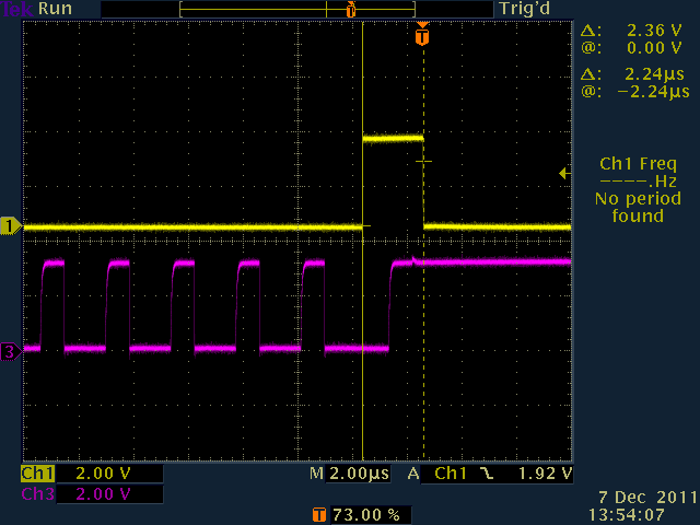

Hi, Giovanni
I measure time of polling STOP bit. It take about 2.24uS and very stable (SCL period is 2.40uS). Is it really necessary to use delayed polling via dedicated hardware timer? Without it driver code is beautiful and clean. Also, now we can set I2C IRQ priority to lowest value because of DMA usage.
My I2CConfig:
static const I2CConfig i2cfg2 = {
    OPMODE_I2C,
    400000,
    FAST_DUTY_CYCLE_16_9,
screenshot:
http://www.freeimagehosting.net/cea97
Yellow chart up is polling cycle, magenta chart is SCL.
Re: I2C implementation for STM32
Such a polling in IRQ context would degrade heavily the response time of the whole system (we are talking of an RTOS here) which, in case of the STM32F4 is well below the microsecond. I also think that that time is dependent on the I2C speed, probably by setting lower speeds that time would increase making degradation worse.
If the driver API was purely synchronous then a polling of 3uS would be perfectly acceptable because it would be performed in thread context.
