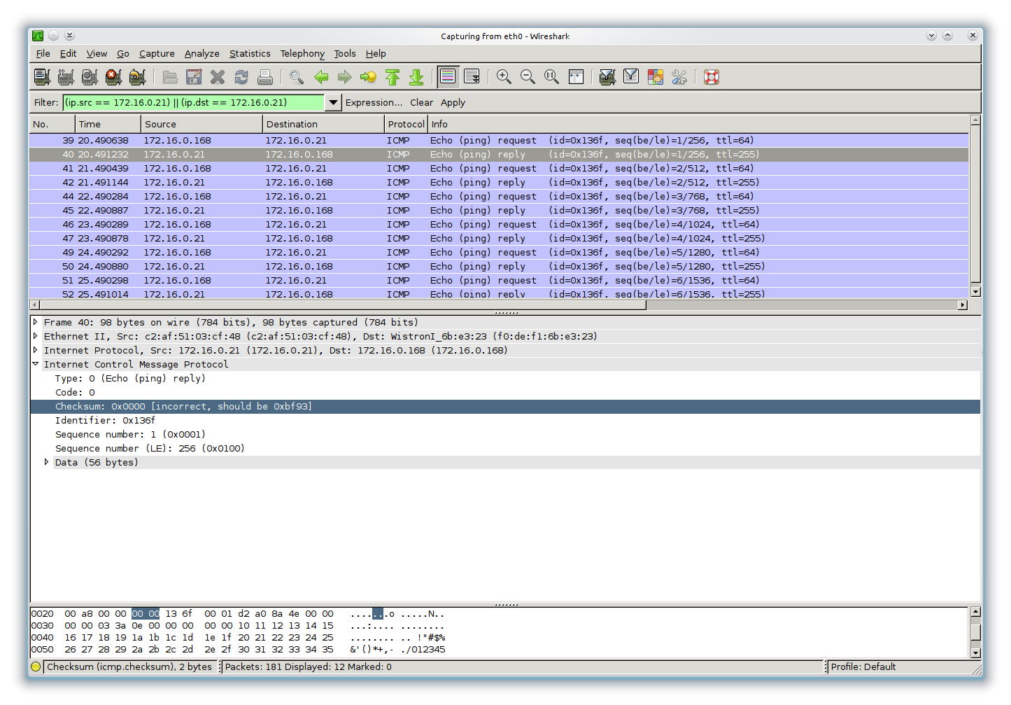

Re: STM32 Ethernet Demo
Hellp santatanta,
I made a quick test as well, and you are right - the ICMP checksum field is zero (see attachment).
The ICMP checksum is above the network layer of switch/network card and therefor ignored. Maybe the Linux ping implementation is ok with a wrong Checksum where as Windows will ignore the packages.
I'll try to dig deeper, but I think the checksum should be calculated when the ICMP part of the packages is generated.
EDIT:
Echo ICMP messages are generated in line 186 in file icmp.c. When checking with the debugger iecho->chksum is indeed set to a value different from zero but this is not seen with wireshark.
EDIT2:
I just found a windows computer, windows does indeed ignore the ICMP ECHO REPLY messages....
EDIT3:
iecho->chksum is even calculated correctly and matches the value calculated by wireshark (bytes must be swaped)
EDIT4:
I have no idea why this happens. The icmp checksum is set correctly. And as far as i can see, the correct package get's transmitted via ip_output_if(p, ip_current_dest_addr(), IP_HDRINCL, ICMP_TTL, 0, IP_PROTO_ICMP, inp); Where IP_HDRINCL basically just tells ip_output_if to forward the package directly to wire. I have no idea where the checksum could have gone missing, as it is just a byte between many others in the IP payload.
EDIT5:
I also tried out the most recent version from git - same issue.
EDIT6:
For debugging I just added iecho->code = 255; after the checksum calculation. The value gets transmitted AND the checksum code is now 0xff00! So I guess this is indeed a problem of the ethernet driver. Maybe the mac does add a wrong checksum. The manual says that the STM32 Mac "calculates and inserts IPv4 header checksum and TCP, UDP, or ICMP checksum in frames transmitted in Store-and-Forward mode".
santatanta wrote:I wonder why you don't have this problem; doesn't your switch/network card care about the wrong checksum?

- icmp.png (228.83 KiB) Viewed 10113 times
According to the STM32 manual:
Setting the checksum field to zero indeed fixes the problem.
Note that: for ICMP-over-IPv4 packets, the checksum field in the ICMP packet must
always be 0x0000 in both modes, because pseudo-headers are not defined for such
packets. If it does not equal 0x0000, an incorrect checksum may be inserted into the
packet.
santatanta
- Posts: 8
- Joined: Fri Jul 22, 2011 11:13 am
Hello mabl,
thank you very much for your quick and detailed analysis.
Yes I'm using a Windows based system, so that's the reason why our pings have different behaviour.
I wonder why I couldn't see the corrupt ping response packet on Wireshark when I used the switched network. I only see the incorrect response with a point-to-point connection.
In another discussion board I read that the original ST demo (with lwip 1.3.2 on a STM3210C board) has no ping problem, even with Windows.
However, with your suggested solution, the ping works just fine.
Thanks a lot for your investigation!
