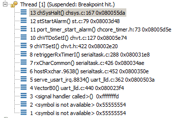

Stack trace for stStartAlarm halt is as follows:
Can't seem to post another attachment, but after the halt the only active timer was the one at 0x20000910. So something strange is going on.

So its not clear why chVTDoSetI() thinks the timer list is empty - as a minimum there should always be one in the list.
Looking at the stack trace in more detail, the timer called from rxRetriggerI() is at 0x20000910, and is being set to a timeout of 100msec - a count of 1000 (0x3e8) given the 10KHz systick.
It may be relevant that the halt always occurs when chVTDoSetI() is starting up a timer from reset, rather than updating a timer which is currently active.
It looks as if the 'idle timer' has gone missing from the list. Is this expected behaviour?

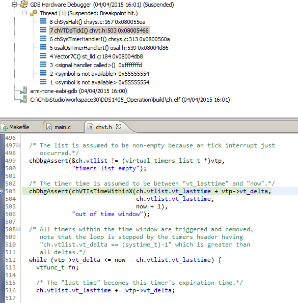

Sorry, but still crashes, although different symptoms; did this after about an hour and a half with DELTA=2
Call stack
Call stack
There are still two timers shown in the debug list, so looks like you've found and fixed the earlier problem.
I've set it running again

Edit: Crashed again in the same way after less than 10 minutes.
The update also included the modified time to system tick conversion macros
I've also noticed that the delta for both timers is >2000. Given that I'm setting my timer to 100msec and have a system tick of 10KHz, this presumably shouldn't happen!
Is it possible that the system time is being incorrectly read?
