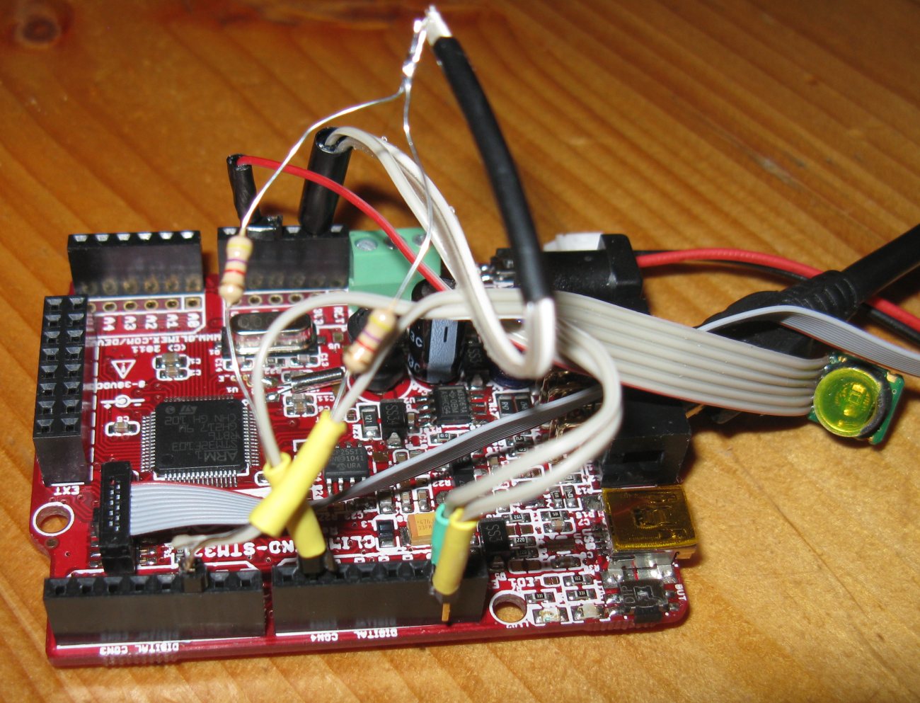

Barthess: Here is my test environment:
My quick and dirty test environment
here is the source I used
chibios.svn-based on trunk r4564.rar
(60.65 KiB) Downloaded 651 times
I'm using usb-serial. type in shell command "i2c" to start the test
Martin
Re: [STM32] I2C HAL driver problems and fixes
Martin,
I really can not understand why your code works. In addition to TMP75 and LIS3 I have tested 24AA eeprom IC. In all cases I get errors.

Martin,
We both have the same STM32F103RBT6 MCUs but with different revisions (your revision is "1", my is "Y"). Probably this is reason.
