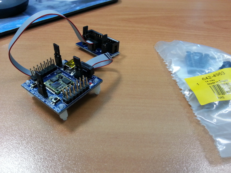

I've been unable to get one yet. I got one of the new Discovery-M1 however, cool stuff.

.. do you mean L1 M3?..
Re: [TODO] The New STM32F429/F439
Basically it is the iNEMO M1 mounted on a small board with connectors.
Those who build quadcopters will love it.
