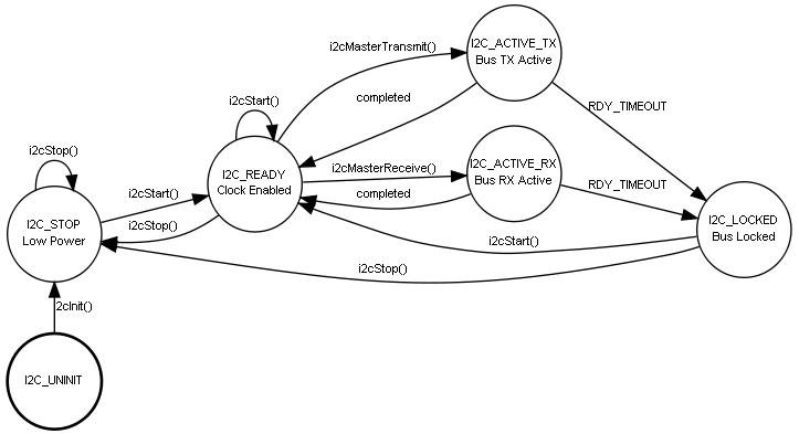

Also, I modified the state diagram as follow:
This is done in order to force a driver restart if a timeout happens, because it is an anomalous condition that triggers an I2C hardware reset and that requires a driver restart.
