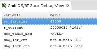

Clear, it is related to the 16 bits counter you are using (systick at 2000 * 33 = ~2^16), this is why I asked. I will look into this tomorrow.
Probably some of the changes forced by MISRA rules broke something in that special case.

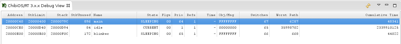

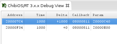

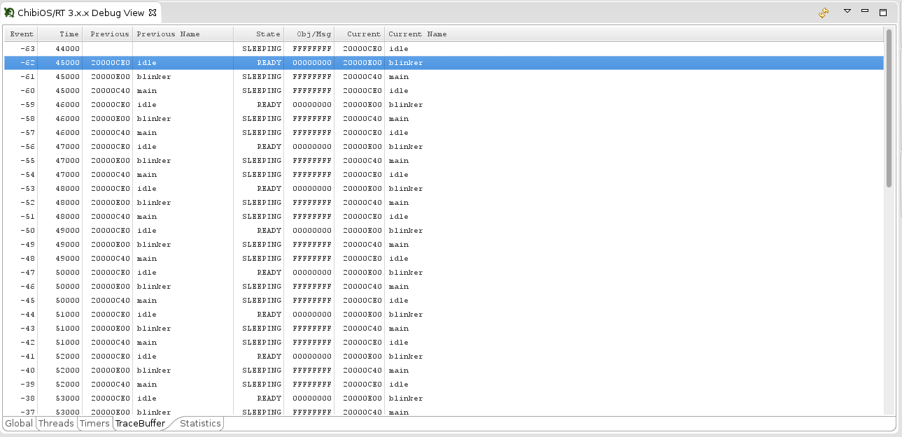

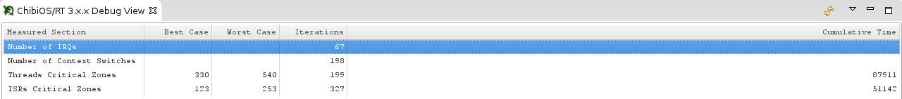

This is what I get while debugging, after it gets stuck, I hope it helps.
