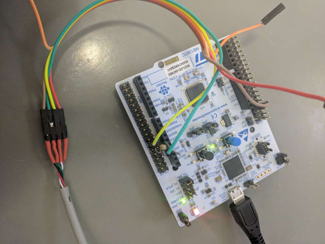

Sorry, but I look at the NUCLEO board and there is no USB jack on it. :(
So I can't simple to try the driver.
Usually it is always there, I did not expect this.

Hi.
What are You waiting for - "USB MADE SIMPLE" from simple USB A cable :)
I checked the driver - it is working from current TRUNK:
Windows detected the Virtual COM Port, Terminal receive the test suite results.
I used my demo KEIL project.

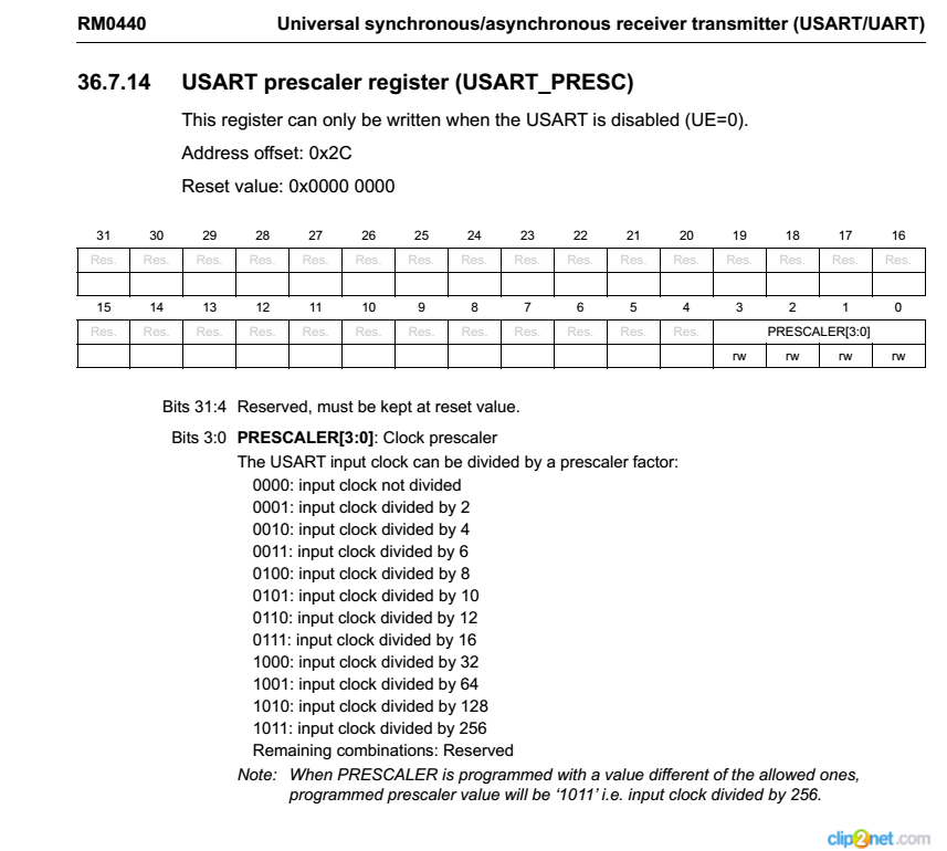

Also USART not fully supported in case for PRESC registers settings.
Thus on 170Mhz an assertion is triggered for BAUD RATE = 9600:
<\os\hal\ports\STM32\LLD\USARTv2\hal_serial_lld.c>
258  osalDbgAssert(brr < 0x1000, "invalid BRR value");

Re: [DEV] STM32G4xx support
Post by FXCoder »
Alex,
The BRR assert is a minor pending fix to be applied.
viewtopic.php?f=35&t=5378
