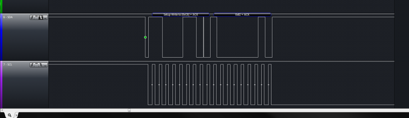

now using the new driver as well and having issues here. I have a STM32F0 Discovery connected to 4 of TMC222 motor motion controllers, which used to work fine with the I2Cv2 driver supplied earlier by doceme as a patch.
My point is, that if i use
i2cMasterTransmitTimeout(&I2CD1, addr>>1, command, txLength, buffer, rxLength, MS2ST(10));
I get the adress byte thrown on the line and ACKed, then the command byte also ACKed but then the SCL line keeps low, the SDA line gets high. Seemes like an endlessly streeetched clock cycle. I found, some Cypress PSoC had same issues, see here: http://www.cypress.com/?id=4&rID=38929.
No STOP contition is generated and my slaves can't supply an answer on the sent intend.

Hey guys, sorry, no net connection during weekend. So here we go again. I saw the fix for bug #400, which adresses the DMA issue, right.
I didn't get any hints by the compiler or linker regarding interrupt vectors or similar...
Now I will try with the latest SVN code rev. 5591.
Also I found a screenshot laying around on my desktop which was generated by Saleae logic for the purpose of showing the result on the I2C lines.. hoping that this will disappear now, I still want to show off the behaviour I experienced last friday.
Thanks for the replies anyway.
Cheers
____EDIT1:
After using the mentioned SVN revision of code it freakin just works :-)
Thanks for alle the support again!
Keept it up.
Cheers
Stefan
Saleae Logic screenshot
