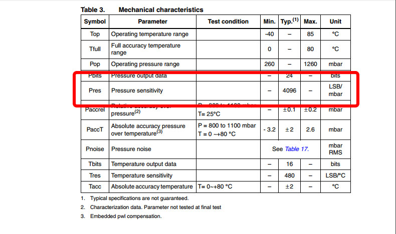

thanks for this precious feedback. I am working on a restyle of the current implementations. We are far from the definitive version and the idea is to improve driver until we have something suitable for most common uses.
Note that bias and sensitivity are two abstract concept related to a linear correction according to formula
Sens * Data + Bias = Cooked
Whereas Data is a 1xn vector, Sens is a nxn matrix and Bias is a 1xn vector. Since cross sensitivity values are almost 0 in our model we are considering Sensitivity like a nx1 vector.
By the way:
The second point... My bad! I have to improve the whole error management. Thanks for notice me.
Re: Digital pressure sensor Driver
Hm... ok, let it be abstract characteristic. But BMP085 for example has
settable (via API?) resolution and hardwired sensitivity. Also
RoccoMarco wrote:Sens * Data + Bias = Cooked
formula is incorrect for pressure calculation. Any way, I have
no ideas about common abstract interface for all kind of
MEMS sensors. I have try hard to create such interface
and best achieved conception you can found here https://github.com/barthess/u2/tree/mas ... rc/sensors
I still think it is ugly but have no better ideas.
