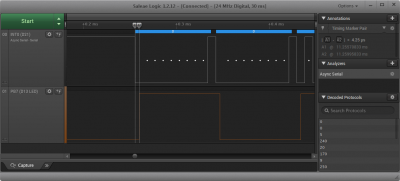

Ah yes, I failed to select the right EXT interrupt channel in mcuconf.h file. Once I did per above latency has dropped to 4.25 uS.
https://ibb.co/eqf9ek
George
PS: I can not find a way to post images (ie logic analyzer screen caps) to this forum. I've tried img tags and url, but it always shows a broken link. If anyone knows how please advise. I think it would add value to the thread. Thanks - George
George

If you want to add an image, when you write a post, see bellow, there is two onglets (Options and Attachments).
Select the attachments and then use the add button to add your image.

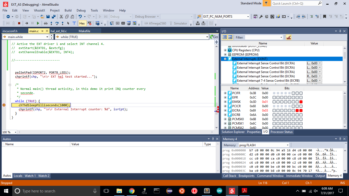

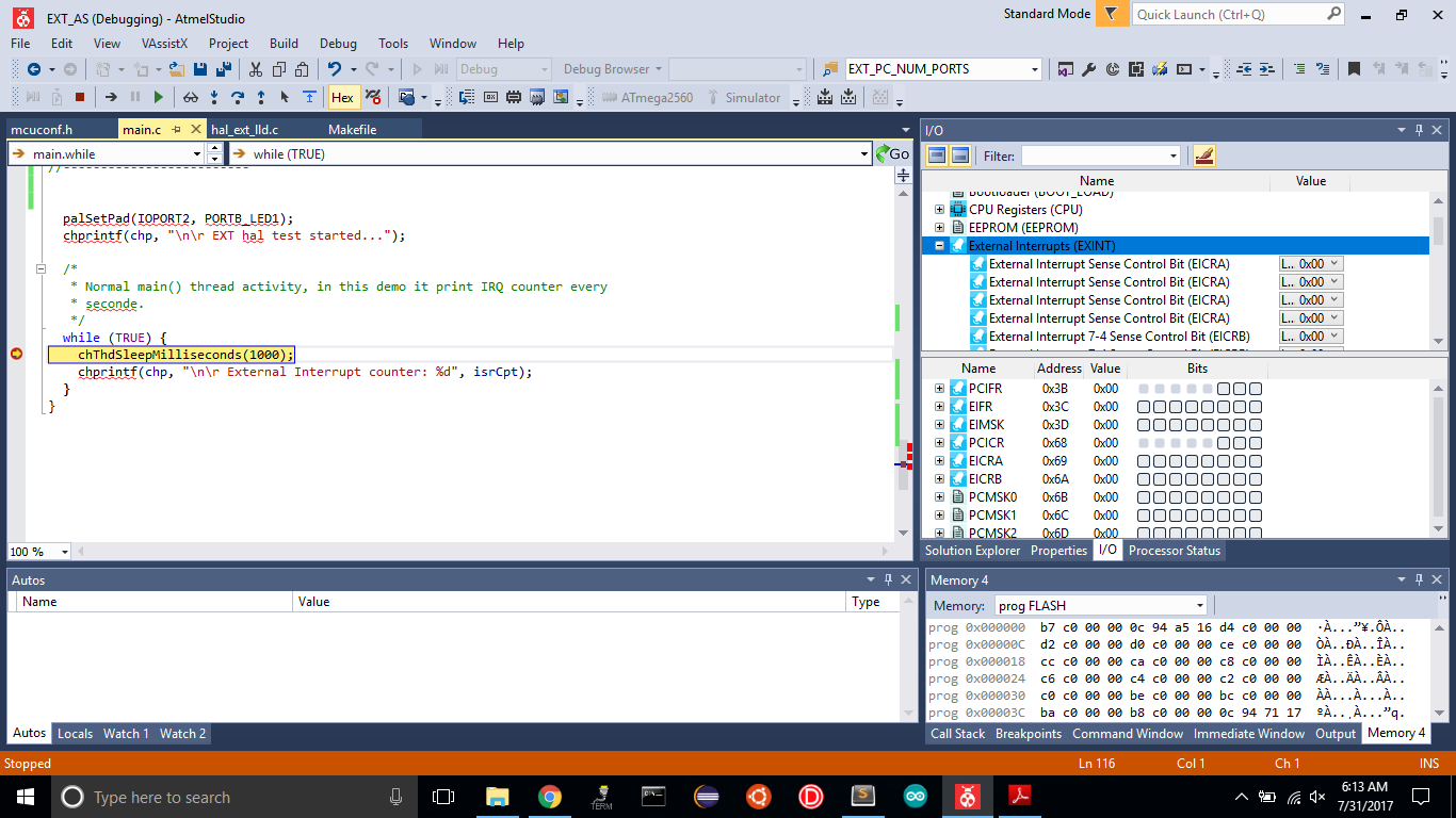

Hi Theo,
I've stated debug in Atmel Studio using simulator. I'm seeing that INT0 initializes EIMSK and EICRA correctly, and INT4 does not (per screen caps).
I'm still trying to grasp the code, but I believe their might be an (not directly related?) issue that the following will not work as intended for non-zero based INT's. If only INT4 is defined, we would still end up with declare_extint_isr(0), which not generate a compile error but would define the incorrect INT0 ISR vector.
