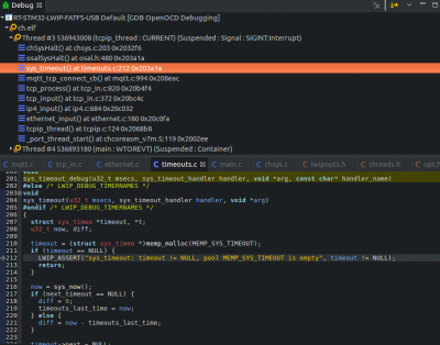

Hi!
I'm a beginner in lwip. The RT-STM32-LWIP-FATFS-USB demo works perfect at STM32F746 discovery.
(latest version 17.6.3, LWIP 2.0.3)
I have implemented MQTT app with official instructions (http://www.nongnu.org/lwip/2_0_x/group__mqtt.html)
But I have issue witch memp_malloc as shown in attachment.
It returns NULL.
Have you implemented official MQTT app with success? Where should I look for a solution?
Thank you a lot.

Re: [INFO] lwIP version 2.0
Sorry, never used that, it could be a memory leak, for some reason elements are not returned to the pool.
