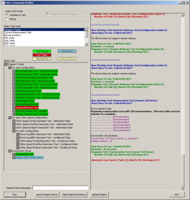

My device with my driver is able to pass USB2CV tests. All I need to do is to comment out chibios's debug checks about already ongoing transaction and to add empty (with bNumConfigurations == 0) device qualifier descriptor. Only except is suspend/resume test, may be it is virtual machine problem because my flash drives produce the same test fail.
- usb2cv_report.rtf.zip
- (2.39 KiB) Downloaded 630 times

I've been mixing the different versions, fixing issues and adding quite some code to achieve both Chapter 9 and MSC compliance these past few days. Here is the interesting bit :
Here is the full log of the MSC compliance : http://pastebin.com/v63jJY9e
It took more time than expected and there's still a bit to verify and clear up. Sadly I have to work on something else for the next few days.
Device is considered compliant with the Bootability specification.
Summary Log Counts [ Fails (0); Aborts (0); Warnings (2) ]Here is the full log of the MSC compliance : http://pastebin.com/v63jJY9e
