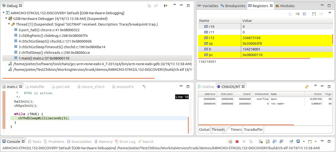

I want to compile chibios for a stm32L151 microprocessor. I use is the last version from svn (trunk: revision 5591) of chibios.
I tried to run the ARMCM3-STM32L152-DISCOVERY demo project but after the fist context switch the eclipse debugger gave an error stack overflow. After this I changed the main.c code to:

sadly the fist time the program calls sleep. The debugger stops again with a stack overflow.
In mcuconf.h I disabled the LSE because my board does not have an external crystal.

One thing I noticed, is that after the call to the function chSysInit(). The chibios debugger plugin shows a stack overflow for the main thread. With a STM32F4 the eclipse plugin also shows a stack overflow for the main thread after chSysInit() but after the fist call to chThdSleepMilliseconds(5) the stkUnused is suddenly valid and the program does not stop.
Print screen when the debugger is stopped

I will look into this in the evening, did you try to increase the stack size for the main thread? also, what debug options do you have enabled in chconf.h?

Hi Giovanni
I changed all the debug options to TRUE.

I changed in STM32L152xB.ld __main_stack_size__ from 0x0400 to 0x0800 and after this to 0x0F00. It didn't help.
I also increased __process_stack_size__ from 0x0400 to 0x0800. It also didn't help.

Which compiler are you using? I would not rule out a problem with the toolchain.

I tested the STM32L-Discovery demo from the repository but I am unable to reproduce the problem, it just worked. Is it possible something is wrong with your toolchain setup?
You could try to use ChibiStudio and see it solves your problem: http://sourceforge.net/projects/chibios ... ibiStudio/
