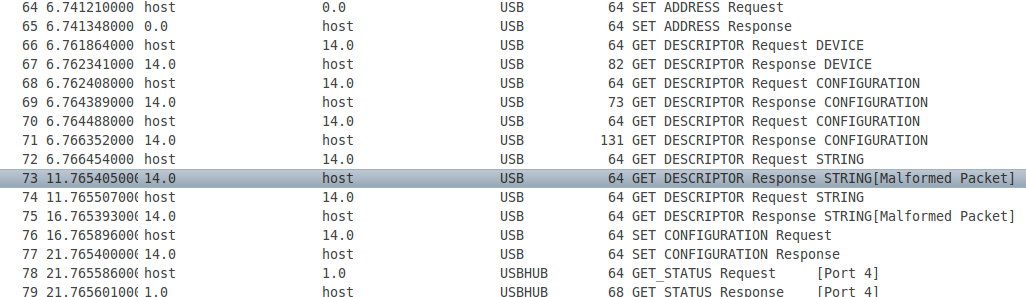

Result: If optimization level is -O0 or any other but with -Otime everything works, but without -Otime system hangs as soon as USB host enumerate device. Look at the attached traffic and a wireshark screenshot.
error upon "GET DESCRIPTOR REQUEST string"

Please enable the debug options in chconf.h and look for stack overflows. Note that the USB driver has an internal thread too.
I also see a 131 bytes-long descriptor, the current driver does not support descriptors longer than 127 bytes because HW limitations on EP0 (there is a bug open about this already, it is an HW limitation but a workaround should be possible).

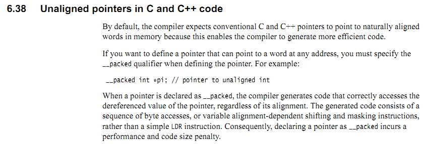

As I read from docs, UNALIGN_TRP bit is a unaligned access exception trap bit. Yes, it is disabled (0) by default in CCR register. But in one chapter of ARM architecture doc about binary compatibility of ARMv7-M they suggest to enable this trap bit, so it would generate exception upon unaligned access like in current usb_lld.c . I can't figure out where UNALIGN_TRP bit is set or reset. Maybe it is needed to be explicitly set to '0' in the STM32 startup code?..
Any way the docs from ARM give better solution of using __packed qualifier for pointers which are casting to possible unaligned data. So, do not rely on "unalign must be turned on", and explicitly use __packed qualifier for such cases. What you think, Giovanni?
As an example:
was
*fifop = *((uint32_t *)buf);
becomes
*fifop = *((PACK_PTR uint32_t *)buf);
where PACK_PTR defined as
#define PACK_PTR __packed
in chtypes.h in analogue to PACK_STRUCT_xxx
I attach patch for this. This is only for RVCT port for ARMCMx and also must be checked and patched for other ports. For GCC it probably would be __attribute__((packed))
With above modifications usb_lld works well. More effective solution would be a correct and explicit enable of hardware unligned access in Cortex-M3/M4.
